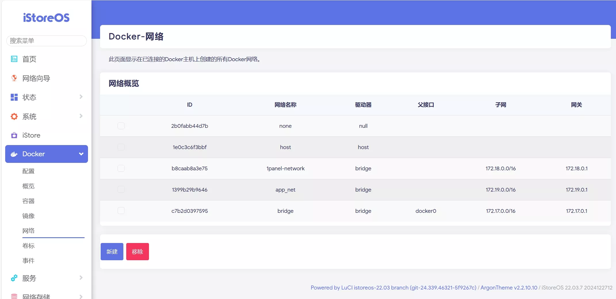

2、安装了1panle,容器起来后,容器内部无法连接外网,容器内可以ping通主机ip192.168.20.1,但无法ping通docker默认网关172.17.0.1 也无法ping通外网 。

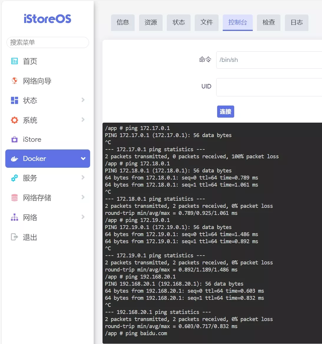

(1)控制台,容器内部 ping结果如下:
/app # ping 172.17.0.1
PING 172.17.0.1 (172.17.0.1): 56 data bytes
^C
--- 172.17.0.1 ping statistics ---
2 packets transmitted, 0 packets received, 100% packet loss
/app # ping 172.18.0.1
PING 172.18.0.1 (172.18.0.1): 56 data bytes
64 bytes from 172.18.0.1: seq=0 ttl=64 time=0.789 ms
64 bytes from 172.18.0.1: seq=1 ttl=64 time=1.061 ms
^C
--- 172.18.0.1 ping statistics ---
2 packets transmitted, 2 packets received, 0% packet loss
round-trip min/avg/max = 0.789/0.925/1.061 ms
/app # ping 172.19.0.1
PING 172.19.0.1 (172.19.0.1): 56 data bytes
64 bytes from 172.19.0.1: seq=0 ttl=64 time=1.486 ms
64 bytes from 172.19.0.1: seq=1 ttl=64 time=0.892 ms
^C
--- 172.19.0.1 ping statistics ---
round-trip min/avg/max = 0.892/1.189/1.486 ms
/app # ping 192.168.20.1
PING 192.168.20.1 (192.168.20.1): 56 data bytes
64 bytes from 192.168.20.1: seq=0 ttl=64 time=0.603 ms
64 bytes from 192.168.20.1: seq=1 ttl=64 time=0.832 ms
^C
--- 192.168.20.1 ping statistics ---
round-trip min/avg/max = 0.603/0.717/0.832 ms
/app # ping baidu.com
PING baidu.com (39.156.66.10): 56 data bytes
^C
--- baidu.com ping statistics ---
8 packets transmitted, 0 packets received, 100% packet loss
/app # ping 114.114.114.114
PING 114.114.114.114 (114.114.114.114): 56 data bytes
^C
--- 114.114.114.114 ping statistics ---
4 packets transmitted, 0 packets received, 100% packet loss
/app # ip route
default via 172.19.0.1 dev eth0
172.19.0.0/16 dev eth0 scope link  src 172.19.0.3
(2)疑问:ping 外网被阻止了,是istoreos系统默认阻止,还是安装了1panle后,被1panle 默认阻止了?
备注:该容器DDNS-GO,同一内网N1盒子上运行,没有此问题,可以ping通外网

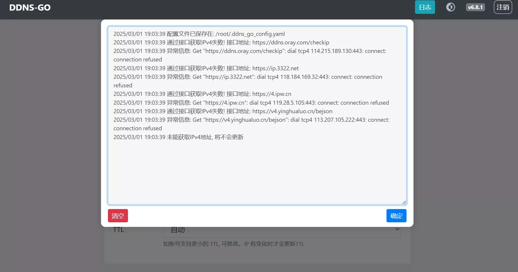

3、运行后显示未获得ipv4
三、请教一下,是什么原因,哪里需要修改?
目前其余都是系统默认配置,请各位大佬指点,如有需要我再补充截图
