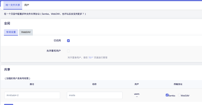

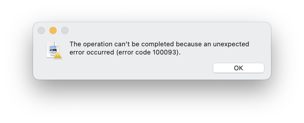

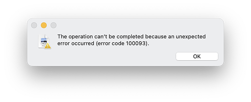

A:在【统一文件共享】开启对于 /mnt/usb4-2 目录的共享,配置登陆可读写。macOS无法写入文件,提示
The operation can’t be completed because an unexpected error occurred (error code 100093).

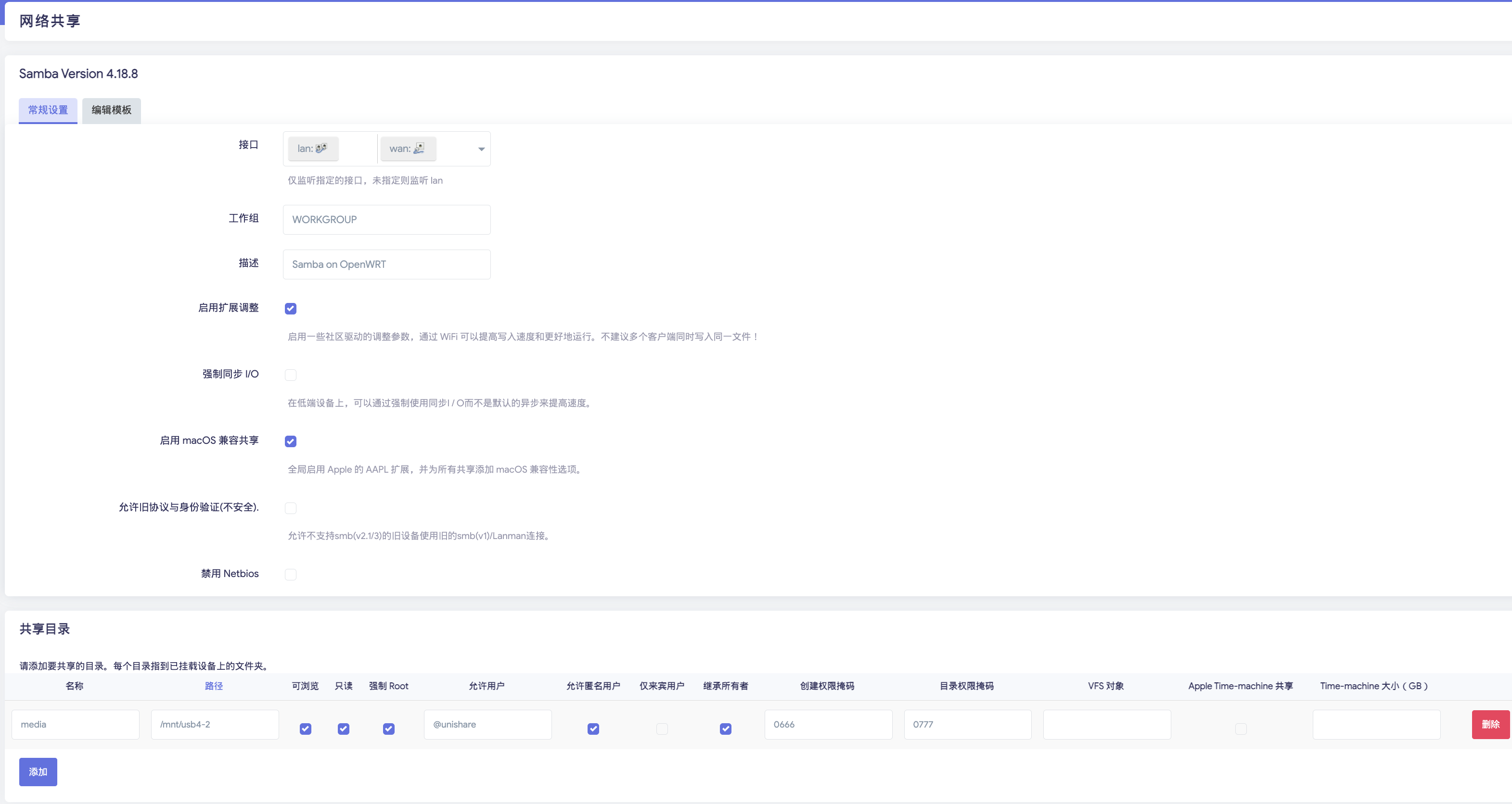

对于smb模板配置文件没有改动,这个是运行时的配置文件
root@iStoreOS:~# cat /etc/samba/smb.conf

[media]
	path = /mnt/usb4-2
	force user = root
	force group = root
	valid users = @unishare
	create mask = 0666
	directory mask = 0777
	read only = yes
	guest ok = yes
	inherit owner = yes
	write list = @unishare
	fruit:encoding = native
	fruit:metadata = stream
	fruit:veto_appledouble = no
	vfs objects = catia fruit streams_xattr  io_uring
